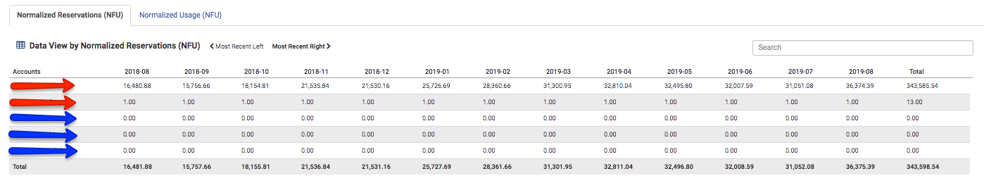

The "Normalized Reservation (NFU)" tabulated report below the graph will show you a breakdown of accounts where reservation value exists. In other words, this represents where the reservations were purchased. In the below example, the red accounts have reservations (with nearly all on the top) and the blue accounts have none:

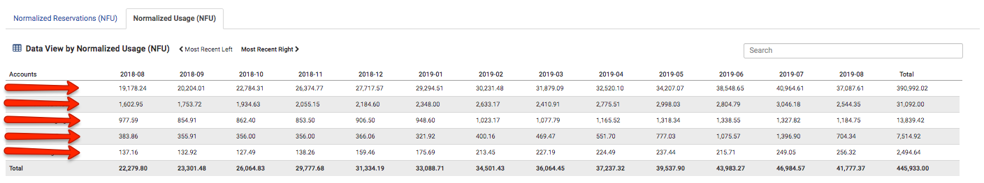

The "Normalized Usage (NFU)" tabulated report below the graph will show you a breakdown of where the reservation coverage could took place. The below example is the same set of accounts as above but it represents usage associated to accounts. You'll notice that all accounts are now red because reservation coverage can float to any of them:
AWS generally invoices using the costs associated to the "Normalized Reservation" breakdown of reservation value (in other words, they associated cost of reservations to the account that purchased them). CloudHealth reports costs based on how reservation utilization floats across accounts and potential coverage is represented in the "Normalized Usage (NFU)" report above.
Neither way of reporting the cost and usage is wrong, but CloudHealth believes that reporting based on actual utilization provides a more accurate view of the cost associated to account reservation coverage.
