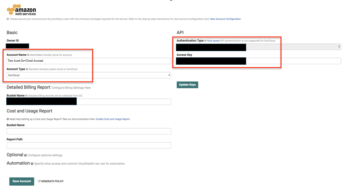

Assets Account Example
- Account Name should reflect the appropriate GovCloud account that houses assets and infrastructure
- Account Type should be "GovCloud"
- Authorization Type should be "User"
- Billing fields should be left blank in all situations
