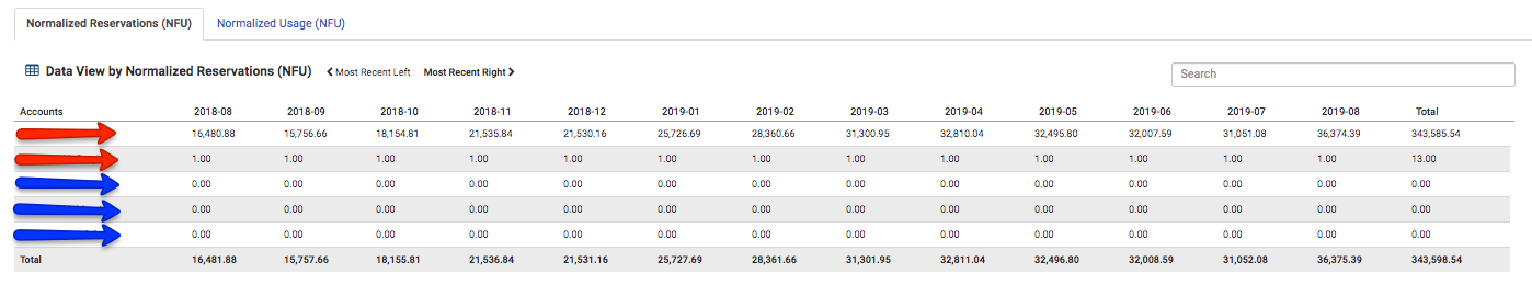

The "Normalized Reservation (NFU)" tabulated report below the graph will show you a breakdown of accounts where reservation value exists. In other words, this represents where the reservations were purchased. In the below example, the red accounts have reservations (with nearly all on the top) and the blue accounts have none:

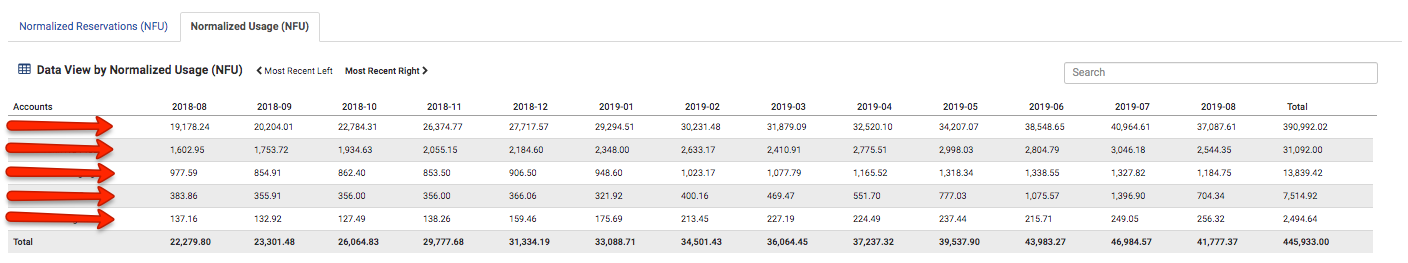

The "Normalized Usage (NFU)" tabulated report below the graph will show you a breakdown of where the reservation coverage actually took place. The below example is the same set of accounts as above but it represents where the reservation coverage floated to other accounts. You'll notice that all accounts are now red because coverage floated to all of them:
AWS generally reports using the costs associated to the "Normalized Reservation" breakdown of reservation value while CloudHealth reports costs based on how float across accounts affected cost represented in the "Normalized Usage (NFU)" report above.
Neither way of reporting the cost and usage is wrong, but CloudHealth determined that reporting based on actual utilization provides a more accurate view of the cost associated to account reservation coverage.
