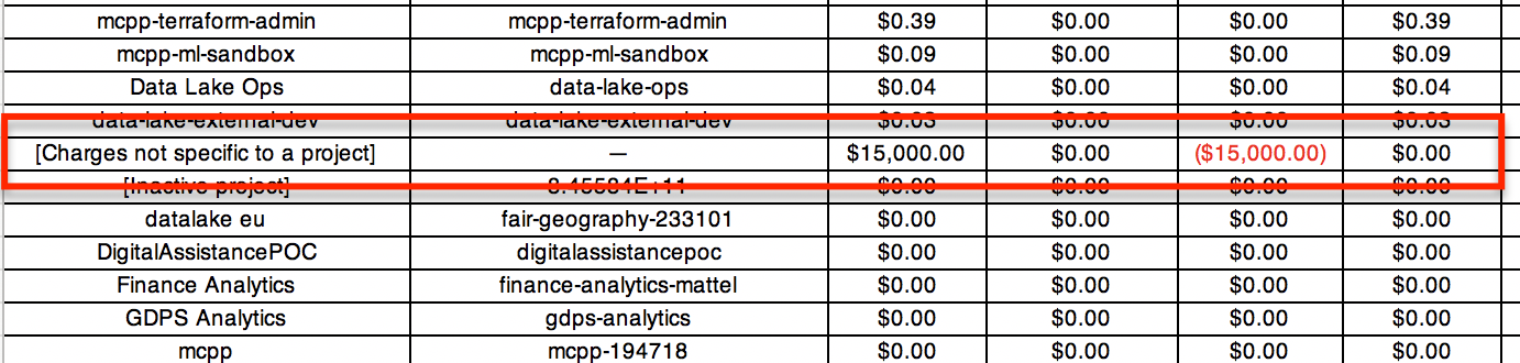

For instance, in the below table you'll notice the project "Charges not specific to a project" is $15,000:
That cost will roll into the total overall cost (which is why total costs will still match up correctly in CloudHealth) but it will be disbursed proportionally out to each project which will seemingly inflate project totals when comparing to GCP (since GCP project totals DO NOT include these charges).
One way in this scenario to attempt to get cost values to match up at the project level is to filter out the "Support - Enterprise" charges in CloudHealth but note that it may not be possible to get the reports lined up exactly:
