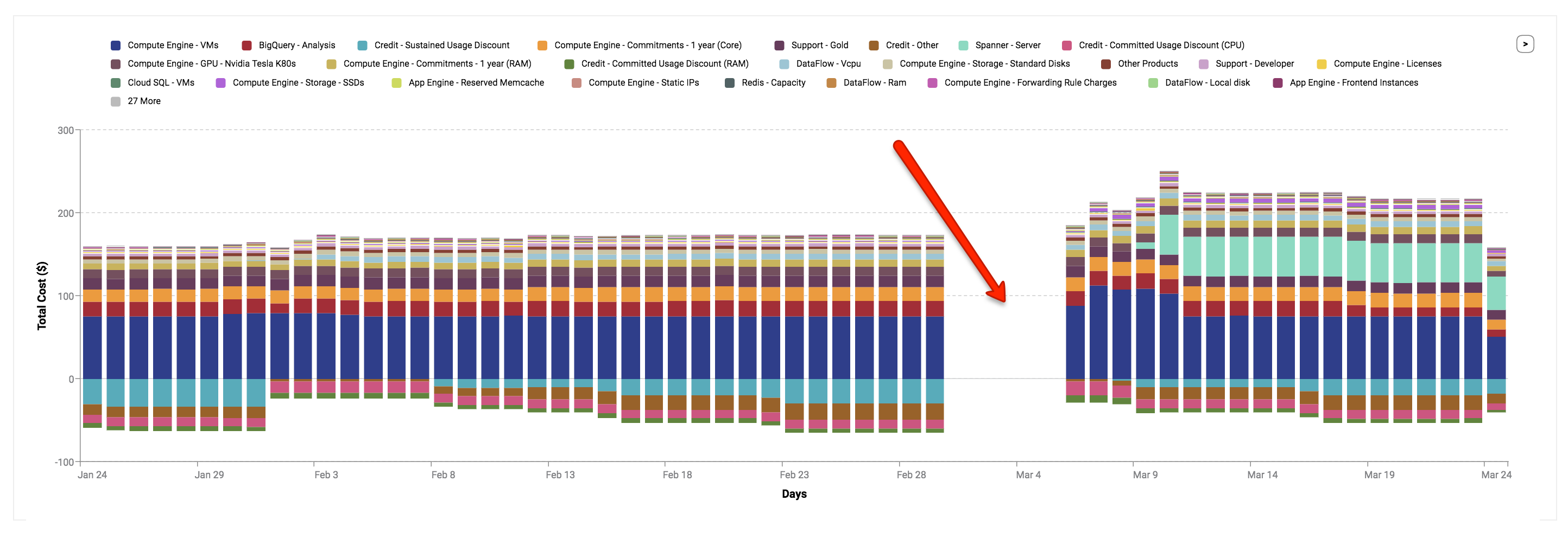

Check the Daily View
There are situations where the total cost won't line up correctly because daily costs weren't fully ingested for a day or number of days.  Looking at the daily view is a great way to quickly get an idea of if the total cost being off is due to missing or incomplete daily data.   Daily reporting anomalies may manifest looking like gaps or very low cost in comparison to surrounding days that can tip you off to a problem:
If you do see a daily period of time that is missing or low, this is definitely the cause of total costs being off and will require a ticket so Technical Support can take a deeper look at the issue.
