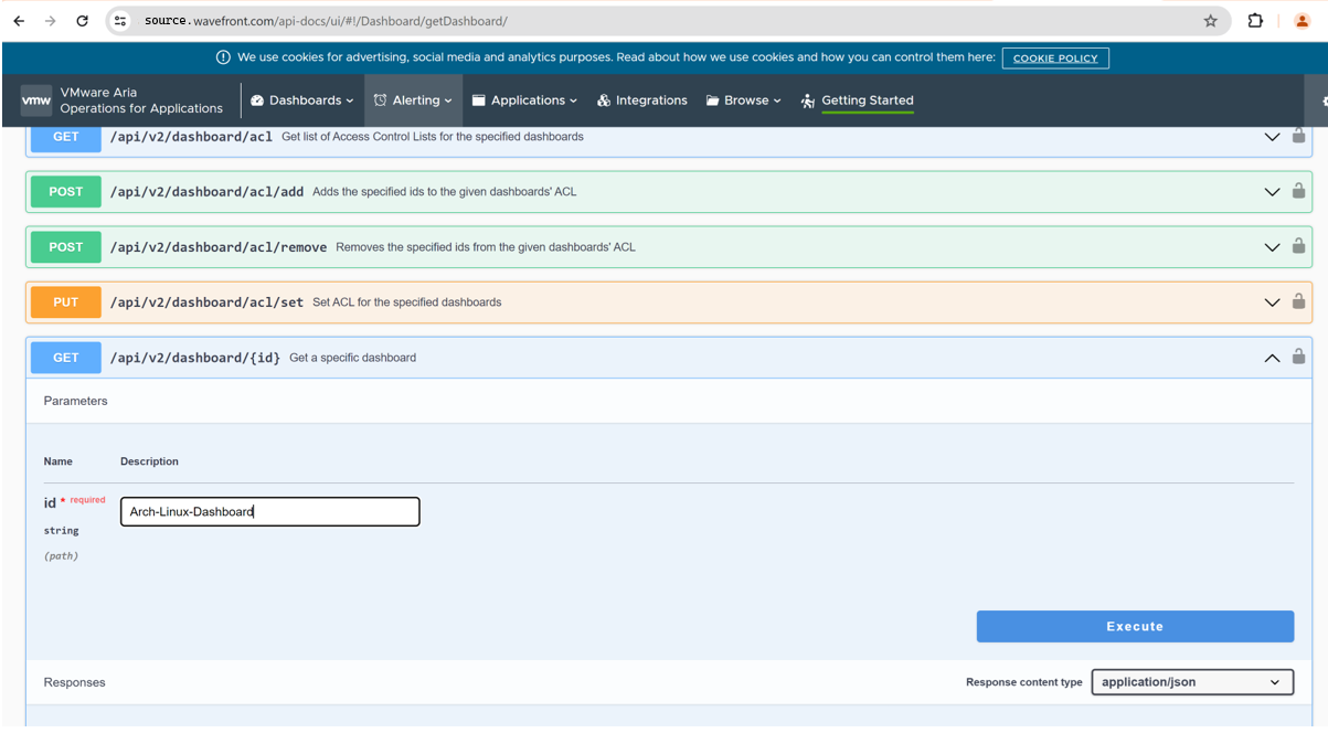

  • Make a GET request to the /api/v2/dashboard/{id} endpoint to obtain the dashboard JSON.

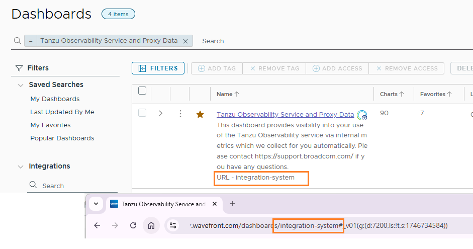

    • The dashboard ID is needed and can be extracted from the link to the dashboard: https://<cluster>.wavefront.com/dashboards/<id>#.
      You can also find the id of the dashboard in the Dashboard Browser. Under the name of the dashboard will be a URL field.
  • When making the API call, make sure you are pointing to the source Wavefront environment URL and using the API token for the source environment.

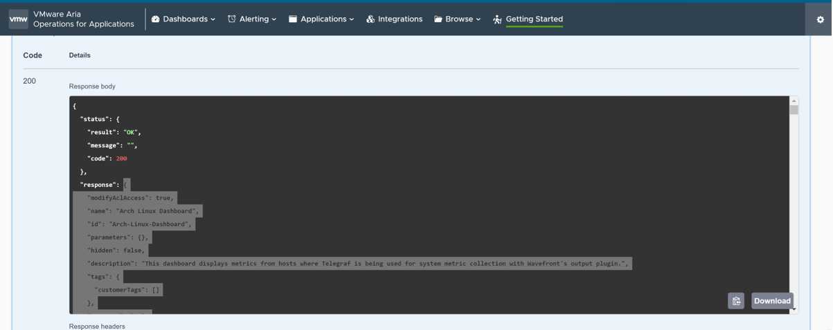

  • Copy the response field of the output. This contains the dashboard JSON.
  • Make a POST request to the /api/v2/dashboard endpoint and provide the JSON obtained in the previous step as the payload. Make sure you are pointing to the destination Wavefront environment URL and using the API token for the destination environment. Once this request completes, the migration is complete.
