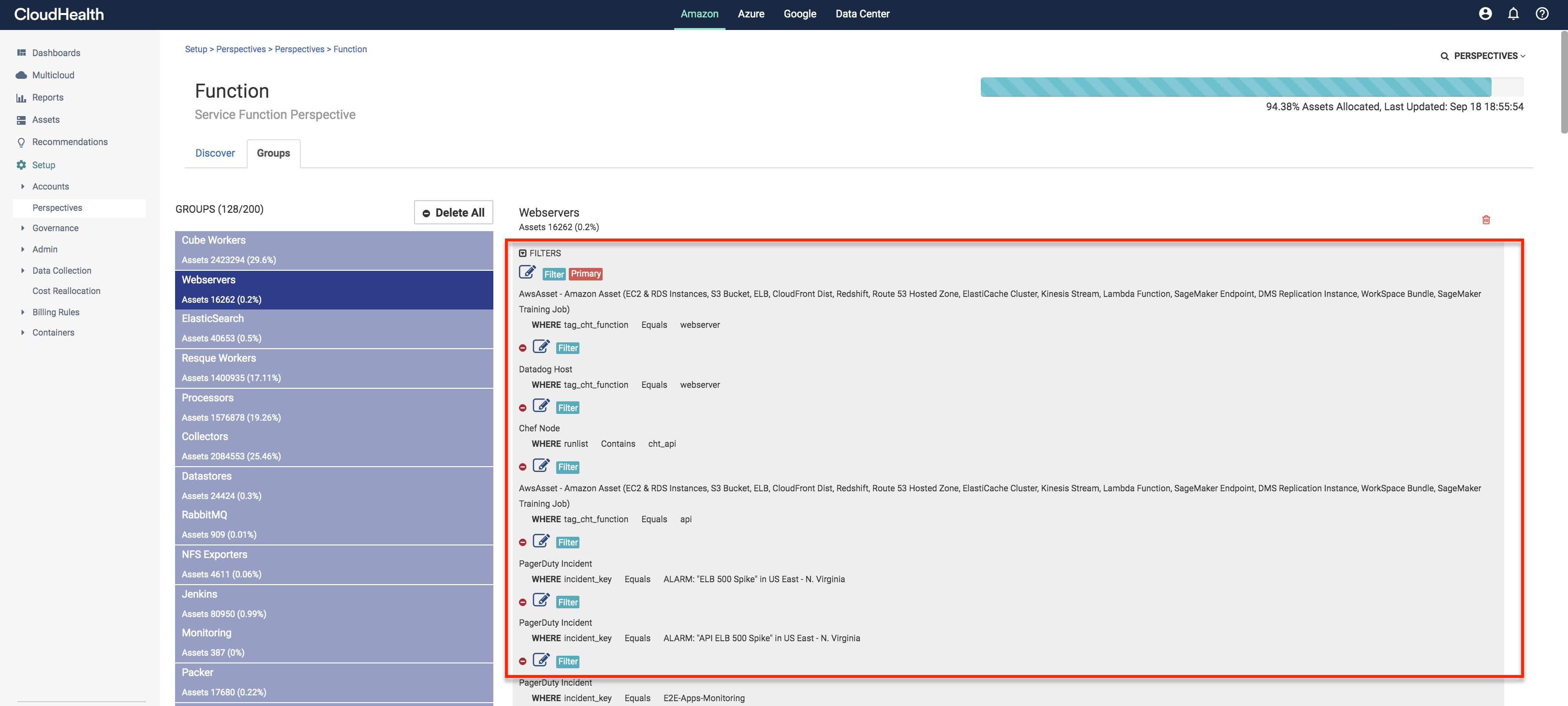

The next step is to get an understanding of the grouping methodology being utilized.  The best way to do that is to take a look at the configuration that appears in the perspective itself.  Navigating to the "Groups" tab and clicking a group will give you information as to how it was formed:
The above example is a very complex configuration but this area is a great resource to get detail into how the perspective was created.  This can also help reveal if there the configuration is potentially incomplete or not optimized.
