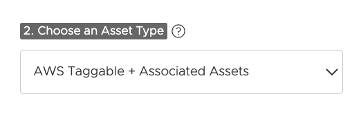

The second step will be to run the perspective group search with "AWS Taggable + Associated Assets":
CloudHealth has created an asset gather tree for the majority of AWS infrastructure under the "AWS Taggable + Associated Assets" asset type.  This means that not only will taggable assets like EC2 instances be recognized and pulled in to the perspective groups, but also associated infrastructure that can't be tagged directly.  Once these groups are recognized, pull them in to the perspective.
Since the "Asset" gather tree asset type is maintained by CloudHealth, there is a chance that it may not include all taggable assets available (generally newly released assets may not show up) so it's a best practice to run the process again using "AWS Taggable Assets Only".
