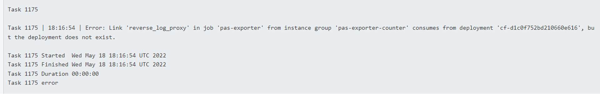

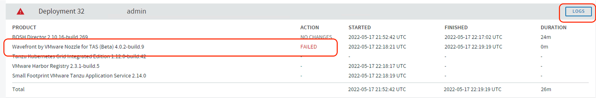

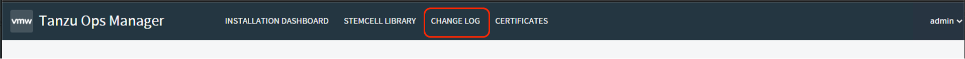

1.   Installation and/or Upgrade problems:  To obtain further information about the reason for the failure, you need to click on the 'Change Log' tab from the OpsManager's main bar. This will take you to a summary of the latest deployment.
To gather more details, please click on 'Logs' on the upper-right corner:

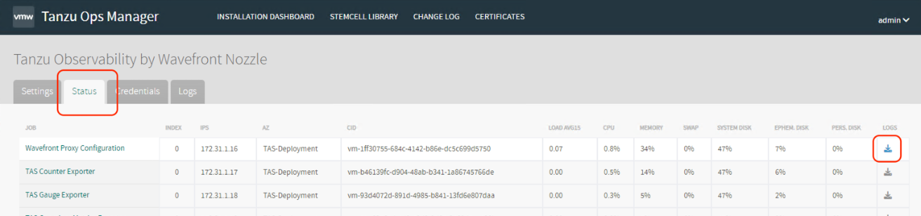

- If via UI, once you click on the Wavefront Nozzle tile,  click on Status tab > Download Logs icon:

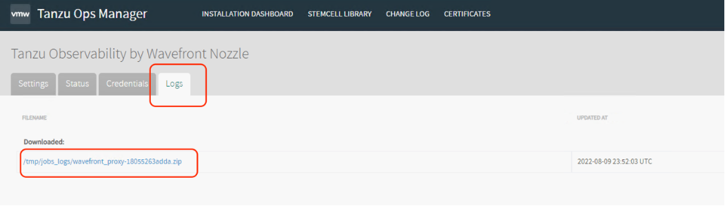

        - Then, go to the Logs tab and download the logs:

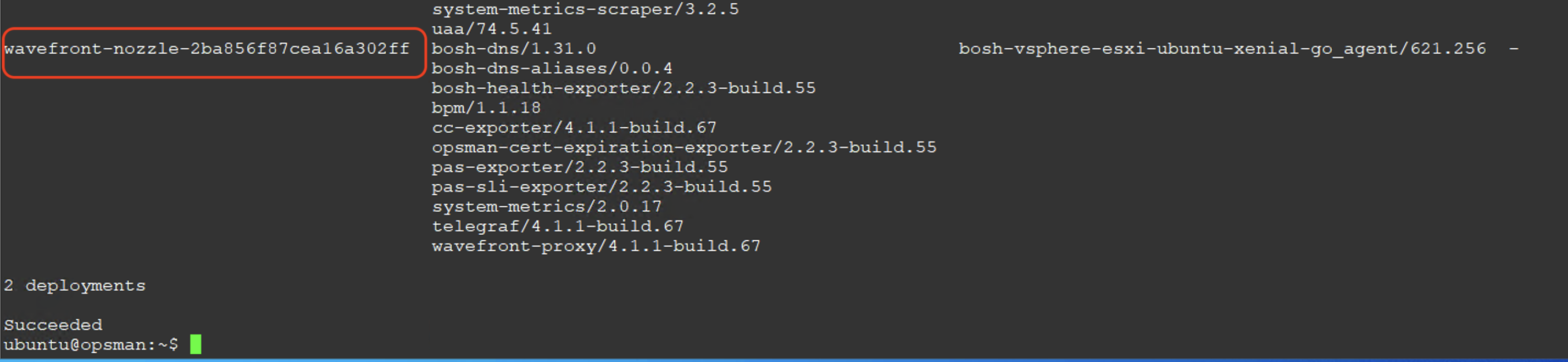

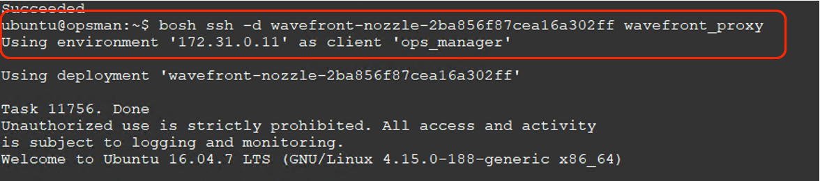

         -  If via Cli, please ask the customer access to the OpsMan's cli and run the following commands:
bosh deps     <-  to identify your wavefront-nozzle deployment
bosh ssh -d wavefront-nozzle-d62c653f58184da09b1d wavefront_proxy    <-  to ssh into the wavefront proxy or telegraf agent
sudo –i           <- to root
bpm logs -fa wavefront_proxy        <- to tail logs
a. bosh deps  :
b. bosh ssh -d wavefront-nozzle-d62c653f58184da09b1d wavefront_proxy :
