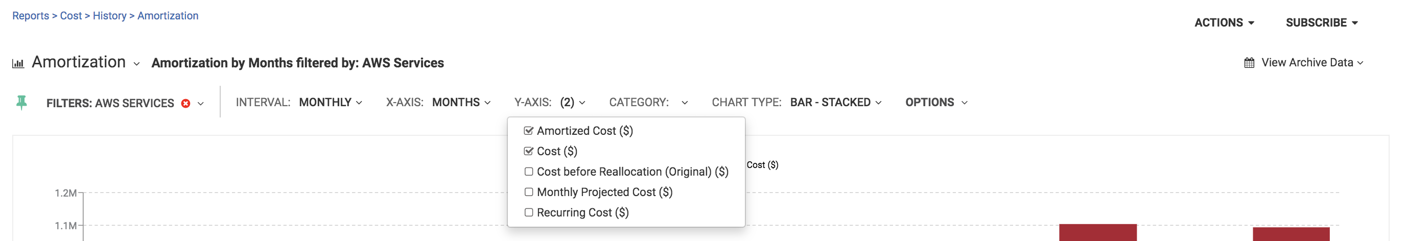

There is a way to line up overall amortization metrics, regardless of calculation type, by looking at the overall monthly totals without any categorization.  The way to view this number in CloudHealth is to navigate to the REPORTS > COST > AMORTIZATION and remove the category type:
The cost that appears under "Amortized Cost" will be the overall total with prepays filtered out if you are viewing from the "Amortization" report (the Cost History report will NOT automatically remove prepays so keep that in mind when comparing data).  This metric can be used to compare the overall total for accounts or specific consolidated billing accounts.  These totals still may not match so it's important to review the timeframe being considered in the comparison calculations.
