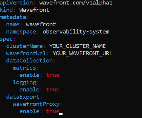

  • Create awavefront.yamlfile with your Wavefront Custom Resource configuration.
  • Add the configuration for logging to thewavefront.yamlfile, for example:
# Need to change YOUR_CLUSTER_NAME, YOUR_WAVEFRONT_URL accordingly
apiVersion: wavefront.com/v1alpha1
kind: Wavefront
metadata:
namespace: observability-system
spec:
clusterName: YOUR_CLUSTER_NAME
wavefrontUrl: YOUR_WAVEFRONT_URL
dataCollection:
metrics:
enable: true
logging:
enable: true
dataExport:
wavefrontProxy:
enable: true
  • Deploy the Wavefront Collector and Proxy with your configuration
kubectl apply -f <path_to_your_wavefront.yaml>
