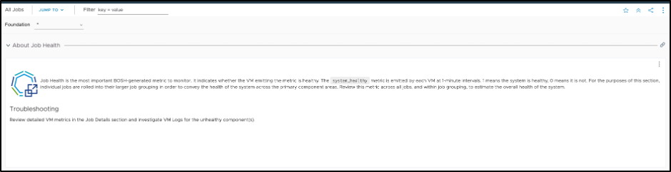

Every dashboard has a header chart that provides detailed information about dashboard.
For example, the “All Jobs” dashboard has the header chart as shown below.
Also, in majority of charts, there is description about what exactly the chart shows (as shown below) and how you can use it to troubleshoot an issue. This allows users to readily understand the purpose of the chart and how to make the best use of it.
