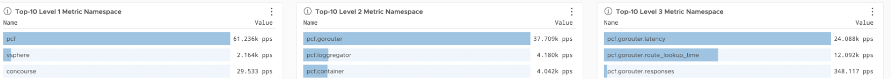

1) Use the namespace explorer to examine the list of metrics which seem to be generating a higher PPS rate than expected. For example, see trend in screenshot attached which shows the PCF namespace as one of the Top 10 namespaces.

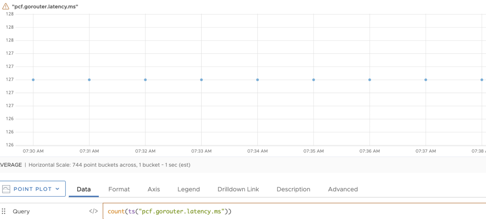

2) Doing a count on the level 3 namespace highlights an anomaly with this ingestion pattern as shown in charts below:
