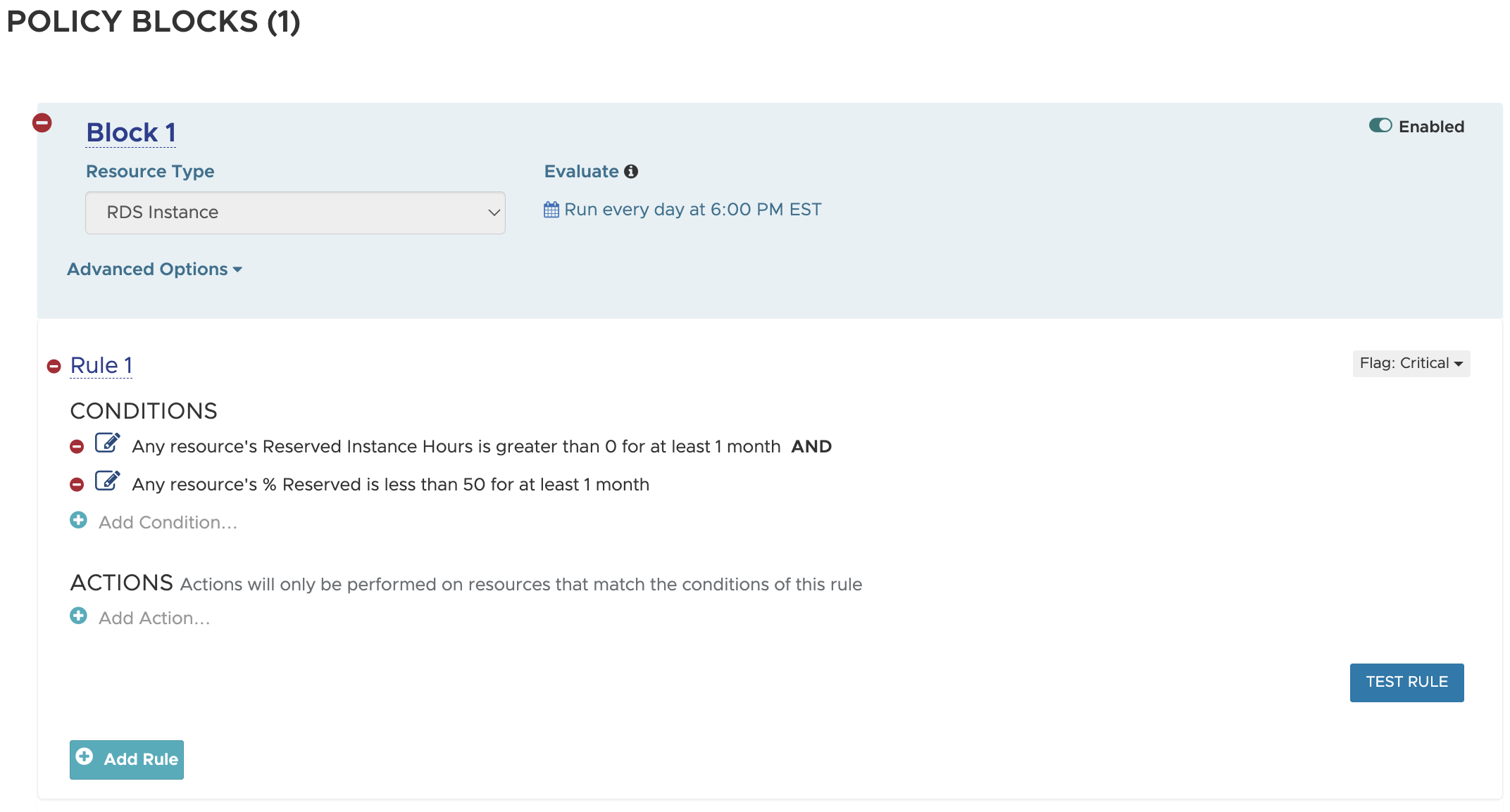

The below method gives an overall alert on RDS coverage:
Create a Policy with two conditions:
  • First check if an RDS instance has any Reserved Instance Hours usage (ie: it is covered, either fully or partially, by an RDS Reservation)
  • Secondly, check if an RDS instance's % Reserved is less than n%
    (for a baseline, check the RDS Instance Hours usage report to see the % reserved per instance).
