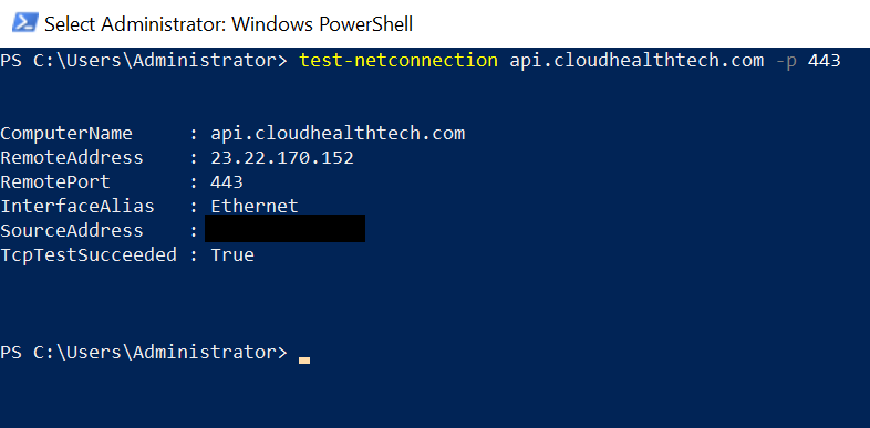

  1. Test connectivity to the api.cloudhealthtech.com on port 443
  2. Execute the following command which matches your environment:
    1. If agent is installed on Windows, run using PowerShell as an administrator:
      test-netconnection api.cloudhealthtech.com -p 443
    2. If agent is installed on Linux, run:
      nslookup api.cloudhealthtech.com  or dig api.cloudhealthtech.com
Below is an example of a response when a successful connection is achieved:
