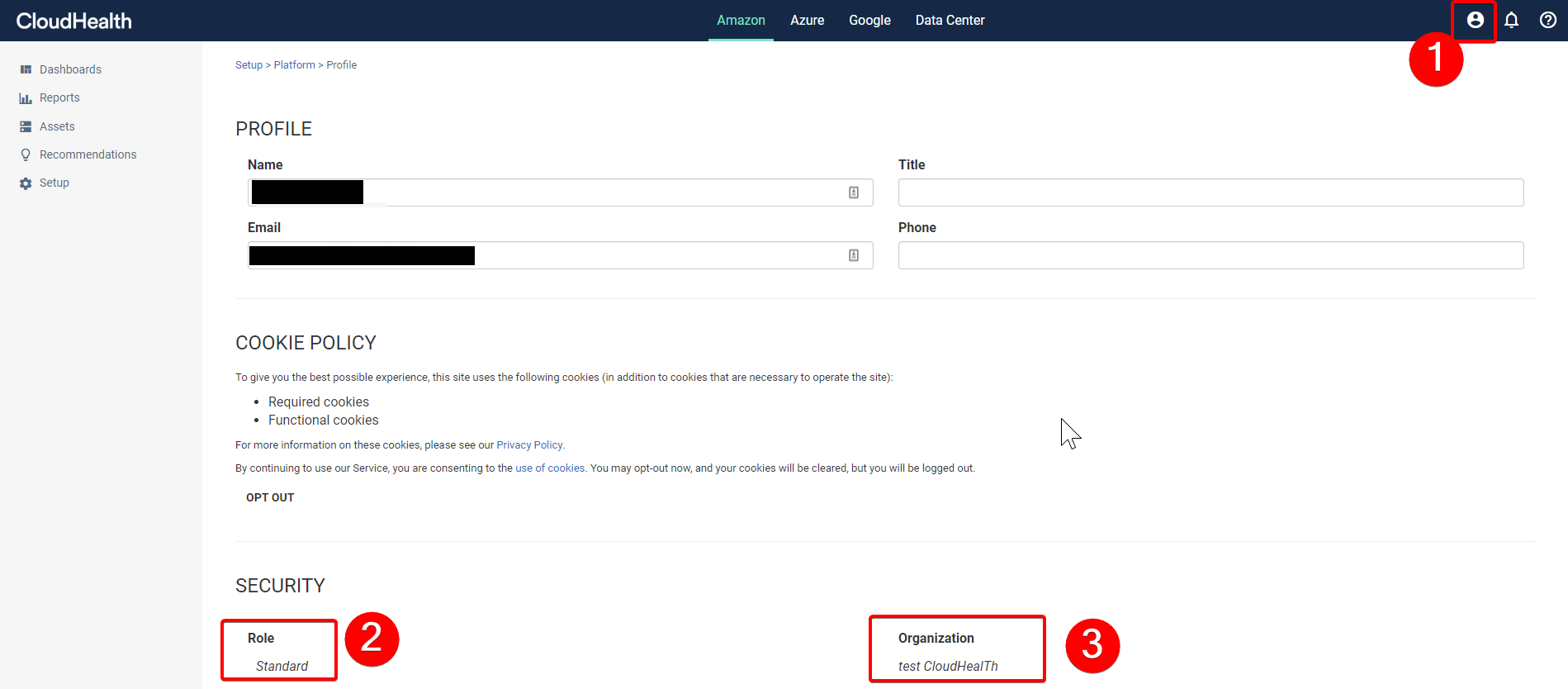

1) Please view your current User Profile by Clicking the Profile Icon and selecting your User Name.
2) Verify your current Role - If you are a Standard User you will not have the ability to make any platform changes and you will need to contact an Administrator of the platform for assistance.
3) Verify your currently Assigned Organization - This information can be useful to pass along to your Administrator.
