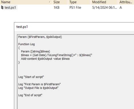

1- Create a SD Package with the powershell script in the source.
Example of script
Param ($FirstParam, $jobOutput)
Function Log
   Param ([string]$linea)
   $linea = (Get-Date).ToLongTimeString()+" : $($linea)"
   Add-content $jobOutput -value $linea
Log "Start of script"
Log "First Param is $FirstParam"
Log "Output File is $jobOutput"
Log "End of script"
This script contains a function Log to write a string into a file
And the following line set the 2 parameters in variable FirstParam and jobOutput
This line must be the first line of the script.

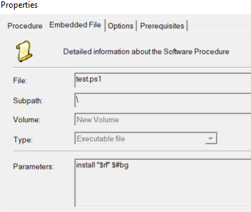

2- Create an install procedure with the powershell script.

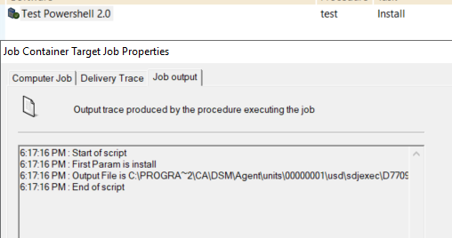

And put install as first parameter and "$rf" in second parameter
3- When this package is sent to a computer the log generated by the powershell script are written in the SD Job Output :
