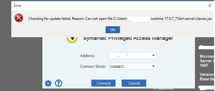

The PAM client is installed on an RDP jump server. Users log on to the jump server and then launch the PAM client to access PAM. This used to work, but now all users get the following error when trying to connect to PAM:
"Checking for update failed. Reason: Can not open file ...\runtime-xxx\bin\server\classes.jsa
Applies to any PAM (client) release.

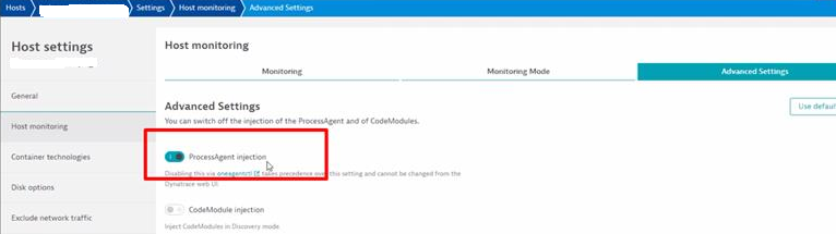

If it is required, turning off ProcessAgent injection should resolve the problem:
If you need the Dynatrace OneAgent and cannot turn off ProcessAgent injection, or turning it off does not resolve the problem for you, contact Dyntrace OneAgent Support to find a solution that works for you.
