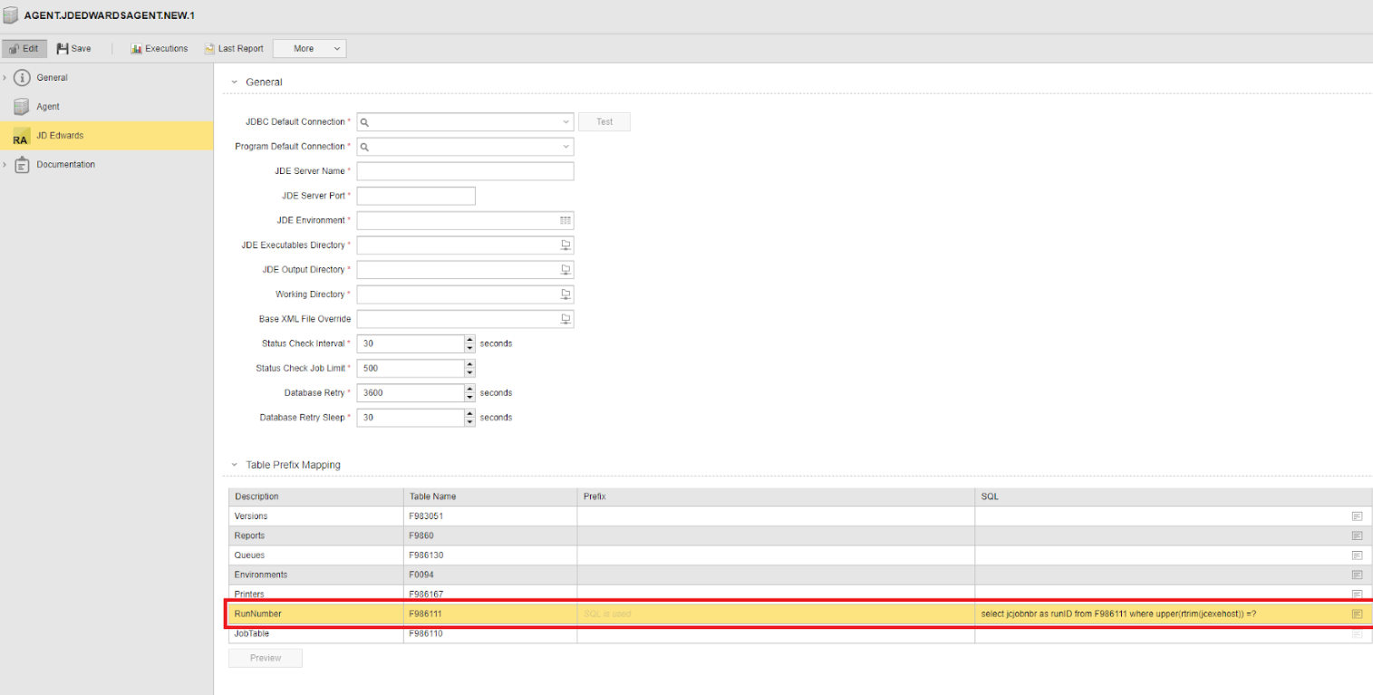

This has been resolved in JDE agent version 2.2.5 published Apr 22, 2024.
This is how the correcting query against the table F986111 should be added to the JDE agent settings
