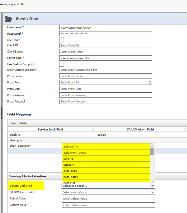

You need to add additional Service Desk Fields in the Field Mapping for our Service Desk connection.
The additional fields are not offered by default in the drop down menu next to "Service Desk Field".
This article describes how to add any additional fields (Eg. add: "contact_type" and "subcategory" )

•  By default in the probe configuration we will have these 3 mapped fields:
<nim_sd_field_mapping>
         name = short_description
         description = description
         affectedCIID = cmdb_ci
</nim_sd_field_mapping>

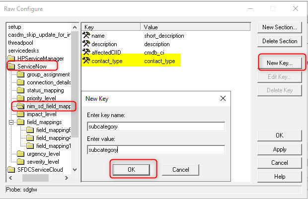

•  To add fields in the Service Desk Section we are interested on do the following:
1. Right click on  sdgtw_standby > raw configure
2. Go to: servicedesks > ServiceNow > nim_sd_field_mapping and then add new keys as below:
servicedesks >ServiceNOW>nim_sd_field_mapping>new key:
contact_type = contact_type
subcategory = subcategory
3. Restart sdgtw and check again.
