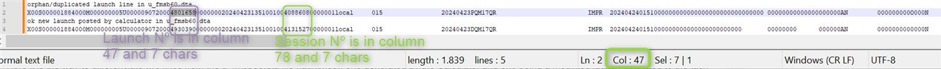

Here it is the way to differenciate two lines from the u_fmsb60.dta file (launches), one generated by the Calculator and one being a modifiied launch detached to the task caused by an Operator modification of the original launch.
Let's take the example before:
  1. Retrieve the lines from u_fmsb60.dta containing the Launch Nº/numlanc which is in the position 47 and the Session Nº which is in the position 78, you can do this with a simple grep command such as:
    grep 4801658 u_fmsb60.dta | grep 4088608 and grep 4930390 u_fmsb60.dta | grep 4131527
  2. Paste these lines from u_fmsb60.dta as above into Notepad++.
  3. Now, we should have a look at position 122 where a "D" marks a launch created from a scheduled task and a "P" marks a launch created "manually" (detached to the task due to the Operators action).
  4. We should also consider the difference at pos 242 ["O"/"0"], where the zero is set by the Calculator: the zero can be seen as a confirmation that the "D" record is created by the task scheduling and that the "P" record is not.
