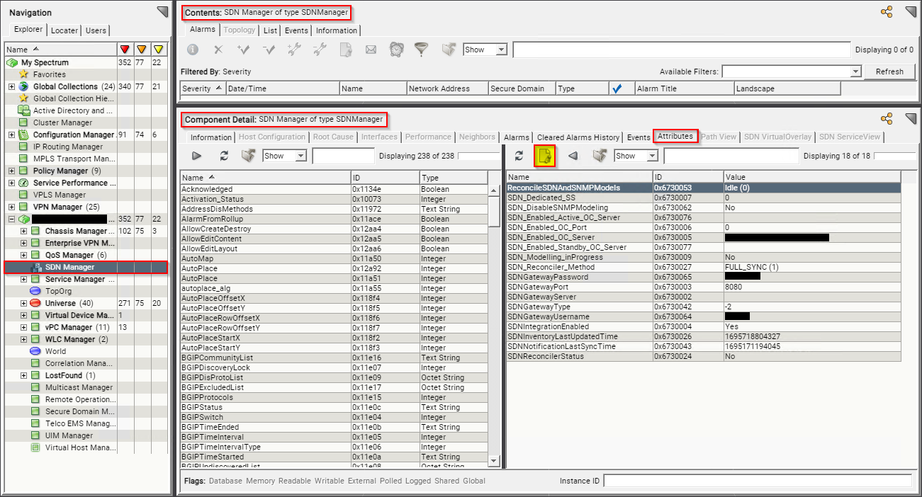

Old VNA Aggregator informations are still in the SDN Manager attributes.
Steps to clean up the SDN Manager attributes:
1. On the attributes TAB of the SDNManager, click on the Edit button:
2. Clear the following attributes:
  • SDN_Enabled_OC_Server (0x6730005)
  • SDNGatewayPassword (0x6730065)
  • SDNGatewayType (0x6730042) set it to 0
  • SDNGatewayUsername (0x6730064)
  • SDNIntegrationEnabled (0x6730004)
  • SDNInventoryLastUpdatedTime (0x6730026)
  • SDNNotificationLastSyncTime (0x6730043)
3. Successfully changed the following attribute values:
4. Enable the VNA integration:
