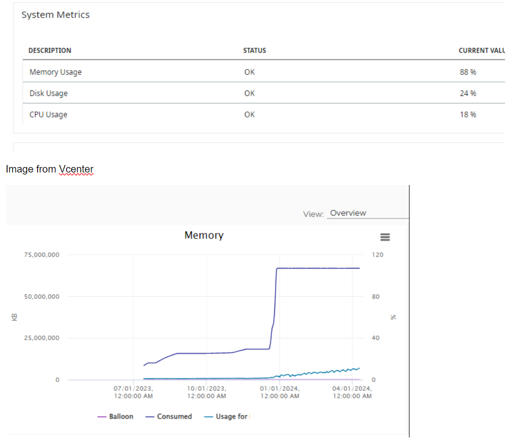

Reporter reports high memory for over months. Please see the snippet below, and advise. accordingly.
From what's been shared the memory is still in the "OK" state, and does not represent a problem. Out of abundance of caution, you may want to do a purge on the database, to have the usage come down.
