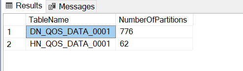

First, run the following SQL Query to check how many partitions the HN and DN tables in question have, substituting the appropriate table name/numbers for the data in question:
SELECT
    obj.name AS TableName,
    COUNT(DISTINCT p.partition_number) AS NumberOfPartitions
FROM sys.partitions p
JOIN sys.objects obj ON p.object_id = obj.object_id
WHERE p.object_id IN (OBJECT_ID('HN_QOS_DATA_0001'), OBJECT_ID('DN_QOS_DATA_0001'))
GROUP BY obj.name;
The exact values may vary depending on the specific values you have chosen for the historic/daily QoS retention:
The important thing is that neither one of them should return a value of "1" indicating only a single partition.

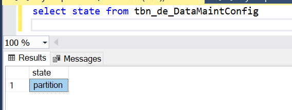

If the value returned is 1, check the following query and make sure it returns a value of "partition":
select state from tbn_de_DataMaintConfig;
If this query returns "basic" this means that your database is not partitioned and this KB article does not apply.  Only proceed further if "partition" is returned. See the "Additional Information" section for details.
