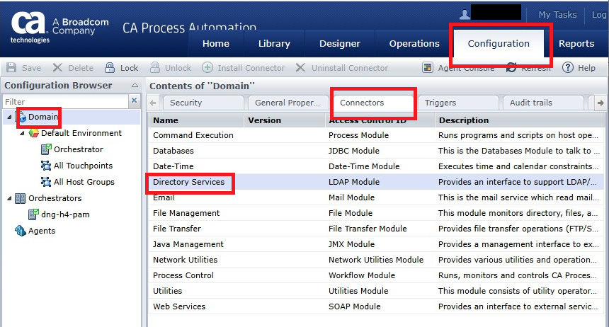

Directory Services configuration page looks like this:
Directory Services configuration page can be accessed via PAM Orchestrator, Configuration Tab.  Choose "Domain" in the left hand pane under "Configuration Browser", select "Connectors" tab, then "Directory Services
ITPAM 4.4 and up
Please add the following settings to the Directory Services configuration page:
 "Security Authentication" --> "simple"
 "Security protocol" ---> "ssl"
After this, and adding any missing certificates to the JDK/JRE cacerts running PAM (or PAM Agent) the operator now works.
