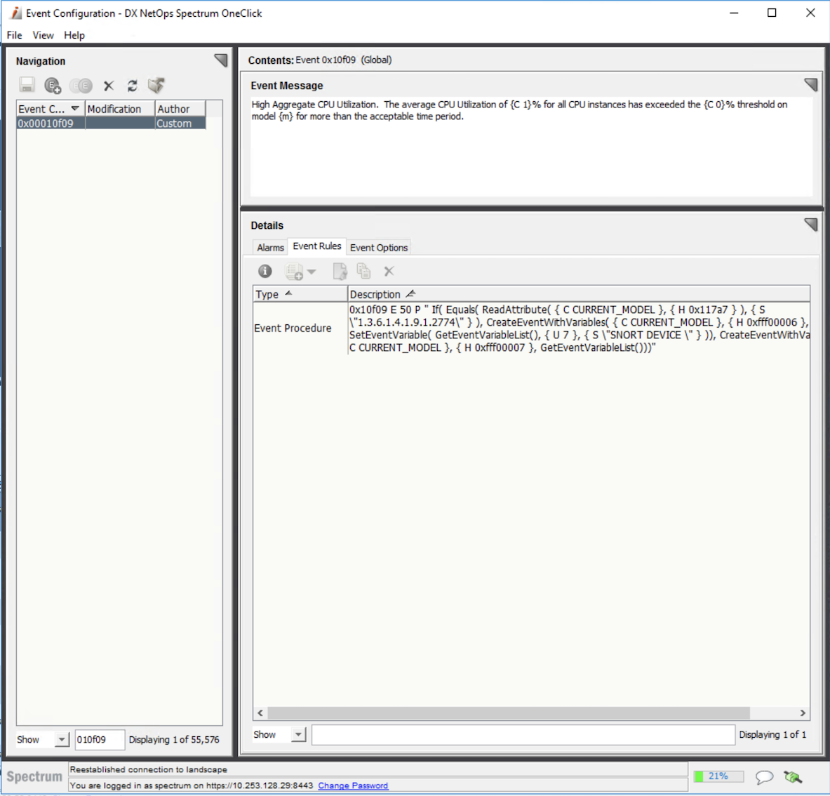

On your system, the 0xfff00006 & 0xfff00007 codes may already be taken, so you would have to create new custom ones and use those instead. The above would be placed in the custom EventDisp file, located under:
$SPECROOT/custom/Events/EventDisp

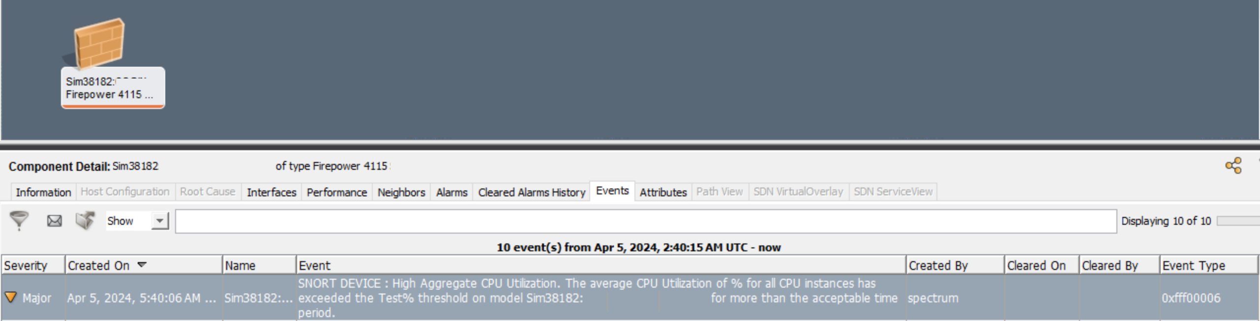

This will override the system default setup for the 0x10f09 event and will appear as follows in Event Configuration:
So the above will start the Alarm Title with "SNORT DEVICE :" and then append the rest of the title ( U 7  }) to it as per:
