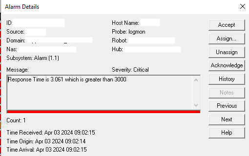

3. if there is match in the log (exceeding last numeric number by 3000) an alarm is raised. Profiles can be tested:
4. If needed, you can create a variable so you can extract the ResponseTime value:
And use the value in an alarm.

            message = Response Time is ${ResponseTime} which is greater than 3000
