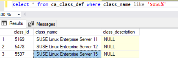

This problem could be caused by missing rows in table ca_class_def
Execute following SQL Query on mdb database and check if class_id 5537 is present :
select * from ca_class_def where class_name like 'SUSE%'
class_id    class_name    class_description
5169    SUSE Linux Enterprise Server 11    NULL
5478    SUSE Linux Enterprise Server 12    NULL
5537    SUSE Linux Enterprise Server 15    NULL
If class id 5537 is missing, this could indicates a problem with "Default Software Contents Download Job".
Check if this job is executed by Engine and if its status is OK.
If it is in ERROR, check the logs C:\Program Files (x86)\CA\SC\CIC\logs\cic*.log
If Domain Manager has not Internet Access, data could be exported/imported from a Domain Manager with Internet Explorer using contentutility.exe tool.
