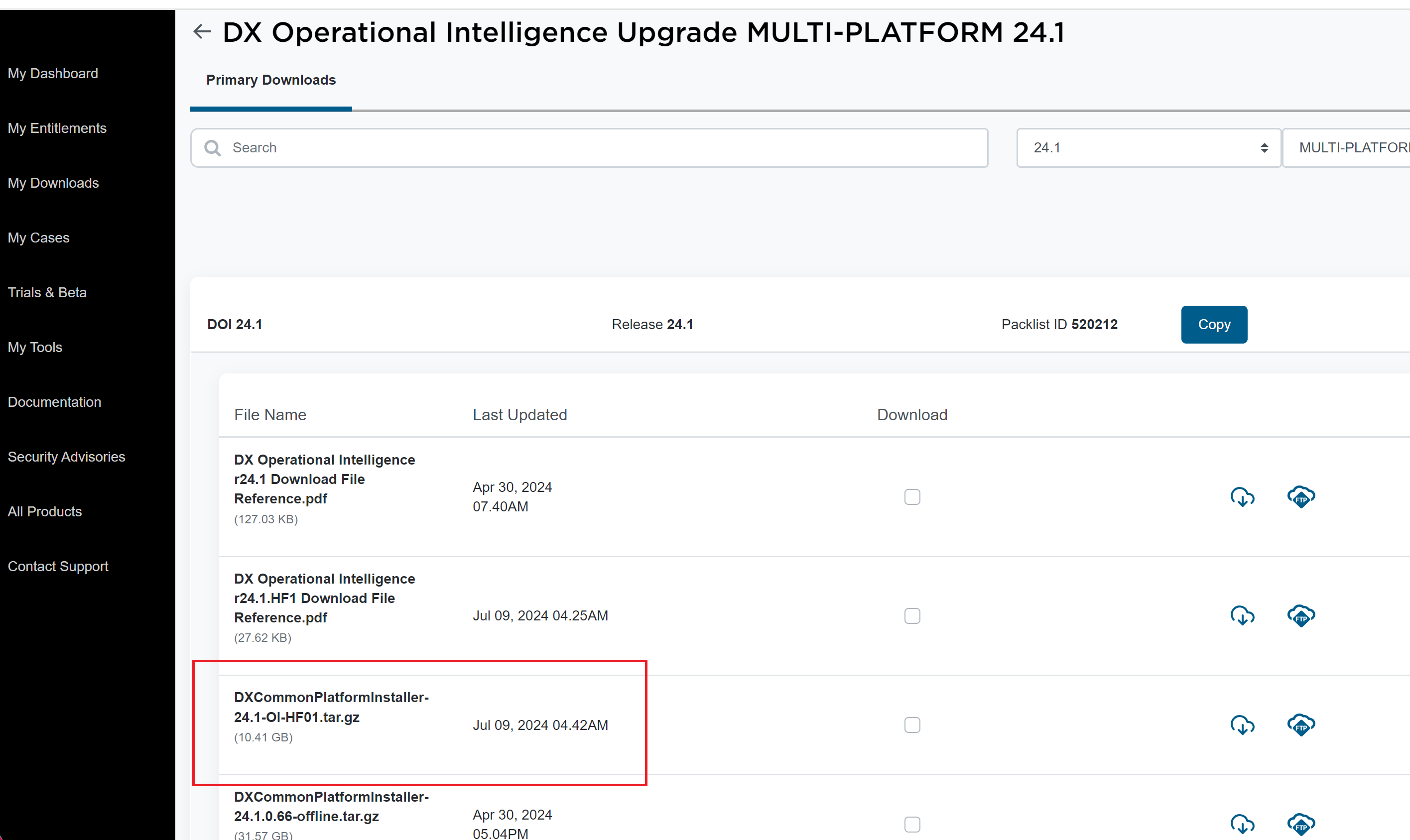

1) Apply HOTFIX DX OI 24.1 HF1  (Note: if you are using OI v23.x, you will need to upgrade to version 24)
a) 24.1 HF1 is available from Support Download site:
b) Apply the additional manual configuration steps to enable the fix:
https://techdocs.broadcom.com/us/en/ca-enterprise-software/it-operations-management/dx-platform-on-premise/24-1/release-notes/241hf1-release-notes.html

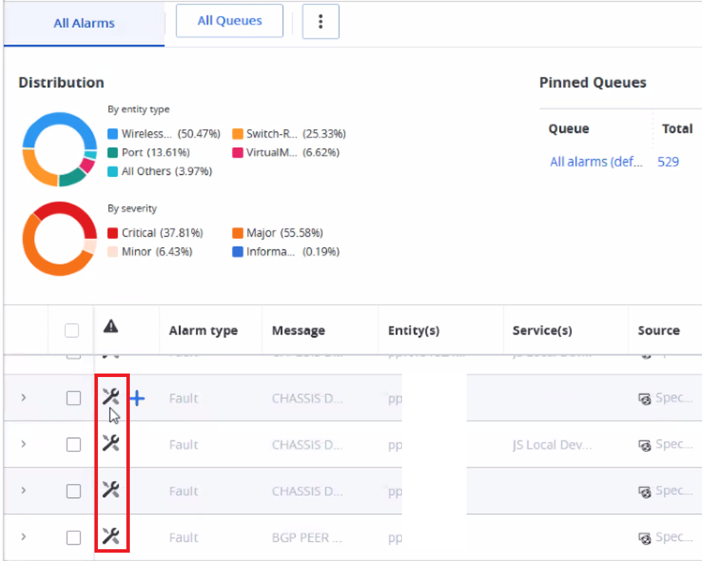

2) After the fix is applied you will be able to filter the spectrum alarms for the devices that are in maintenance by using the "show/hide  maintenance alarms" in the DX OI user interface, below is an example.
