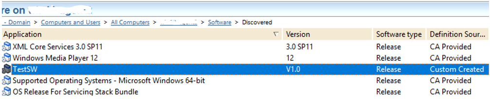

2.- On the Agent, this SW already exists and it's detected under Software -> Discovered section in DSM Explorer:

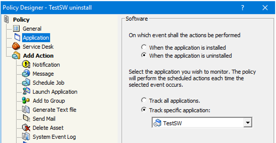

4.- Create a new Event Based policy with the following details:

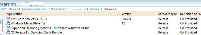

5.- As a way to simulate that this SW was uninstalled, the EXE file was renamed:
6.- After a new Agent cycle, the SW is removed from Software -> Discovered section:
And the notification is shown:

- The policy has to be set to 'Notification', which is the small yellow icon (check the screenshot from step #4).
- Be sure to select the 'Release' of the SW (it has a small circle icon next to the name, check the screenshot from step #4).
- When the Agent runs and updates its SW Inventory, the policy will be triggered, so if you uninstall a SW today, tomorrow (on next Agent cycle, if the Agent ran already that day) the SW will be detected as uninstalled and the notification will appear.
- If after the SW was uninstalled, the Agent is not turned on (or not connected to the network), the notification won't be triggered until the Agent runs at least once.
