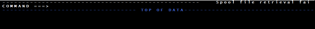

Got "Spool file retrieval failed" when retrieving spool from ESP

When we use WSF command in CSF, we receive the below error as 'Spool file retrieval failed'.
