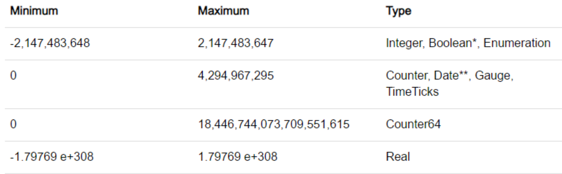

In a watch, If I use an integer input in an expression to multiply the output, the watch stop working when it exceeds the data range of the input data type.
Data Type Integer
Expression ( snmpEngineTime * 100 )
Any Spectrum version
e.g snmpEngineTime is an integer and we need to convert to a larger output via a Watch expression
Once the value of the resulting Watch attribute exceeds the integer value range limit, the watch goes into an error state and stops working.
Covert the integer input to a larger data type for output. E.g. use Counter or 64Counter as the watch data type and convert as follows.
Data Type 64 bit Counter
(UNSIGNED64(snmpEngineTime)*100)
If bracket placement is incorrect, the calculation will be performed on an integer data type and produce an error.
