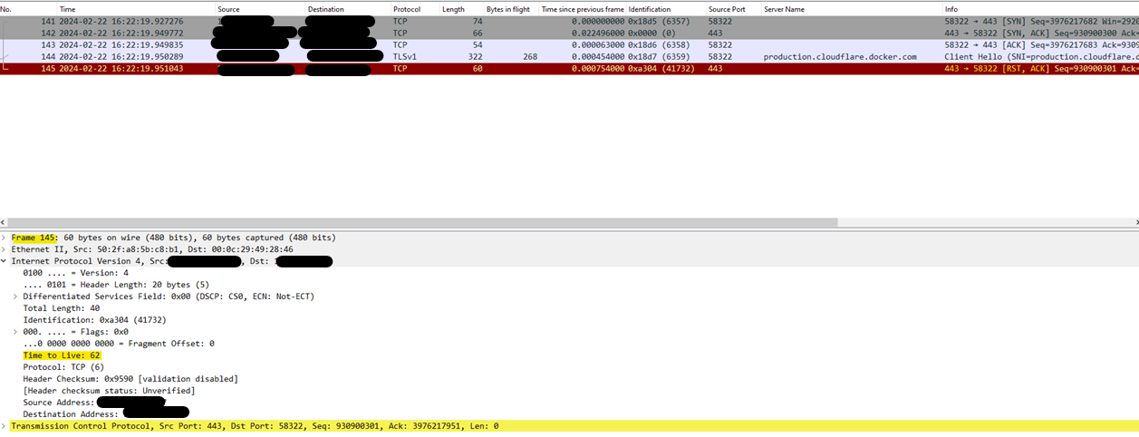

PCAPs showed that an intermediate device (Firewall!) is resetting the TCP connections during the connector install.
Every session to production.cloudflare.docker.com has it’s connection reset, as shown below. You can see the TTL in the IP header is 62; the TTL in the IP header for packet 142 (the original TCP SYN from cloudflare to connector) has a TTL of 54, so it is a different host resetting it.
Looking at the firewall logs confirmed that the device was resetting the connection.
