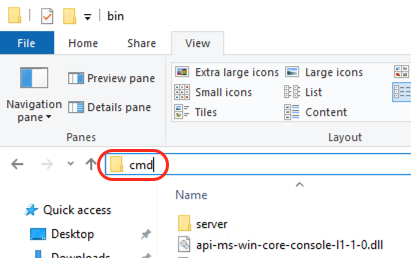

Once you have located the correct folder, replace the contents of the address bar with "cmd" and press enter
This will open a cmd prompt in the correct location to run
