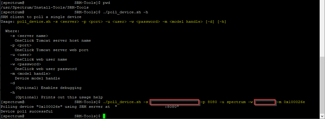

Run the $SPECROOT/Install-Tools/SRM-Tools/poll_device.sh script for specific device model_handle to update the Location field in the reporting database on demand.
