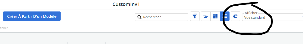

When a Standard View is created for a Workspace, the user will be presented with
a default view named: 'Vue standard'
They have to select the created view in order to not encounter the 'Vue standard'  view again.

Actual: 'Vue standard' shows
The user will be presented with this view.
User has to select the created view.
Every user with the language will have the issue with the created view.
