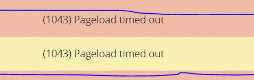

ASM monitor is failing with the error "PageLoad Timeout". Application team says that the webpage was working fine and they suspect that the timout is likely due to the performance issue with the monitor running at the defined location?
DX ASM
The "pageload complete" is an event that the browser would fire when the page has finished loading. The message indicates that something is blocking the event being fired within the specified monitor timeout even when all the requests seem to have completed successfully.
Possible root causes:
- requests taking the longest time, possibly blocking the page load
- requests been blocked by CORS policy
RECOMMENDATIONS: review above points with the app/network team
