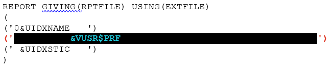

('          &VUSR$PRF                                   ')
(' &UIDXSTIC   ')
Note: The print area to list the profiles is limited by the spaces between the two ‘’ (actual print area highlighted in black below). When all the space is filled up, the print will stop for that variable. To increase the coverage, adjust the spaces accordingly by moving ') to the right.
