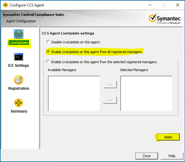

  1. Run the Agent Configuration utility that is located under the Symantec Corporation section.
  2. In the Agent Configuration utility, select the Enable LiveUpdate on this agent from all registered managers option, and then click the Apply button.
