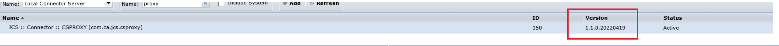

Not deployed CP1/CHF1 correctly. Some missing steps causing JCS shows yet old version.
The JCS admin console is showing an old version 1.1.0.20220419 of csproxy bundle. The correct version of csproxy bundle for 14.4.2 CHF001 is 1.1.0.20231016.
Advised to perform the following steps that resolves the issue.
  1. Stop External Windows JCS Server.
  2.  Back up the "cache" folder available at "<%CONNECTOR SERVER INSTALLED
    LOCATION%>\data" and then delete it.
  3. Start JCS server
  4. Check the csproxy bundle version in JCS admin console, it should read 1.1.0.20231016
