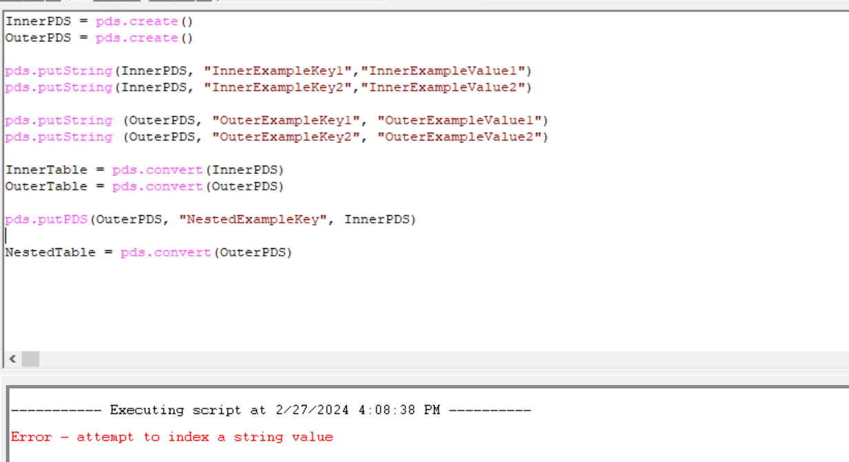

For example - here is a snippet of Lua code that creates two PDS's, an "Inner" and "Outer" PDS and puts a couple of key/value pairs inside each one, and then converts each PDS to a Lua table.
InnerPDS = pds.create()
OuterPDS = pds.create()
pds.putString(InnerPDS, "InnerExampleKey1","InnerExampleValue1")
pds.putString(InnerPDS, "InnerExampleKey2","InnerExampleValue2")
pds.putString (OuterPDS, "OuterExampleKey1", "OuterExampleValue1")
pds.putString (OuterPDS, "OuterExampleKey2", "OuterExampleValue2")
InnerTable = pds.convert(InnerPDS)
OuterTable = pds.convert(OuterPDS)
This code runs successfully.   However, if we use putPDS to embed the "Inner" PDS inside the "Outer" as follows:
pds.putPDS(OuterPDS, "NestedExampleKey", InnerPDS)
Then the conversion as follows will fail wtih the given error:
NestedTable = pds.convert(OuterPDS)
