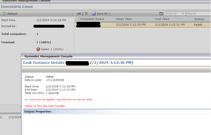

Inventory Task fails when it is run against a client machine (in this example, it was a Linux RedHat machine):
An unknown exception was thrown on server side.
Failed to find the task handler.
The NS logs show that the Task failed:

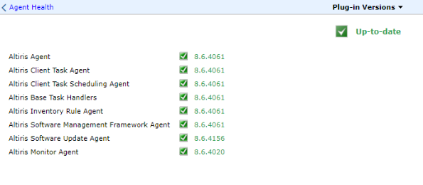

The inability to load the task handler: "Failed to open connection to the task handler 'Altiris.InventoryAgent': 2147483742, Invalid argument" is because if nothing can handle the task then it will fail. In this particular scenario, the inventory plug-in (Inventory Agent) was not installed on the client machine. For the Inventory task to work, it needs that plug-in installed to properly collect the information.
"Note: The following steps are based on troubleshooting on a Linux client machine but the concepts can be easily applied to a Windows machine.

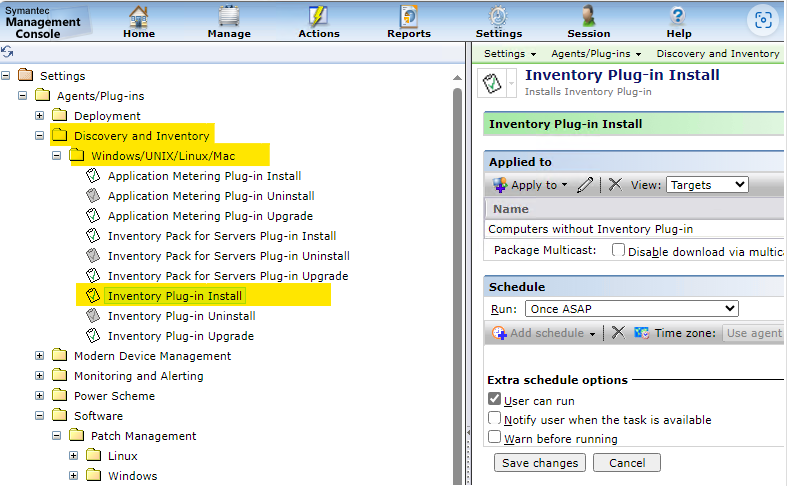

Make sure the Inventory plug-in is installed. You can check this under the "Agent Health" portion of the affected client machine:
If it is not present, proceed with the following:

INFO 2024-02-21 11:29:36.757 844416 139831217510144 SWDAgent > RunJobByID: Job {8B9D8FB0-49EB-45E9-8946-4B8D68F63287}, running command "/bin/sh -c "./rollout.sh" > `aex-helper info path`/aex-inventory-install.log 2>&1" in "/opt/altiris/notification/nsagent/var/packages/{746E0B2E-198A-41E8-90FD-D49AE9A4B5D8}"INFO 2024-02-21 11:29:36.758 844416 139831217510144 SWD > Executing command line "unset LD_ASSUME_KERNEL; PATH="${PATH}:/opt/altiris/notification/nsagent/var/packages/{746E0B2E-198A-41E8-90FD-D49AE9A4B5D8}"; export PATH; /bin/sh -c /bin/sh\ -c\ \"\./rollout\.sh\"\ \>\ \`aex-helper\ info\ path\`/aex-inventory-install\.log\ 2\>\&1"INFO 2024-02-21 11:29:42.526 844416 139831217510144 SWD > Command line result is 0Note:
