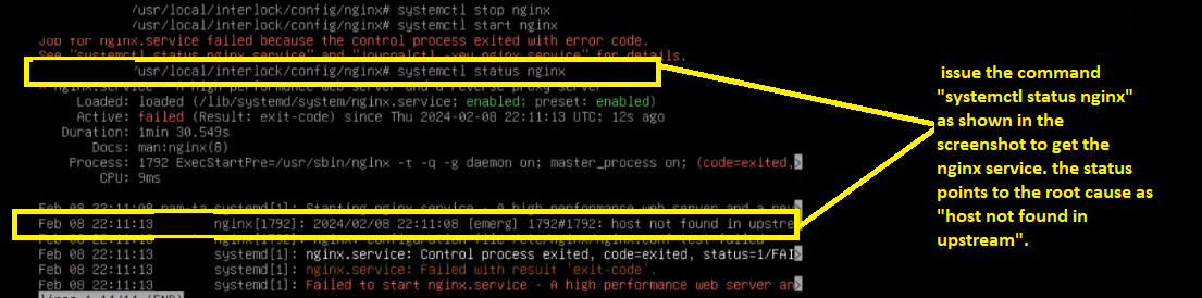

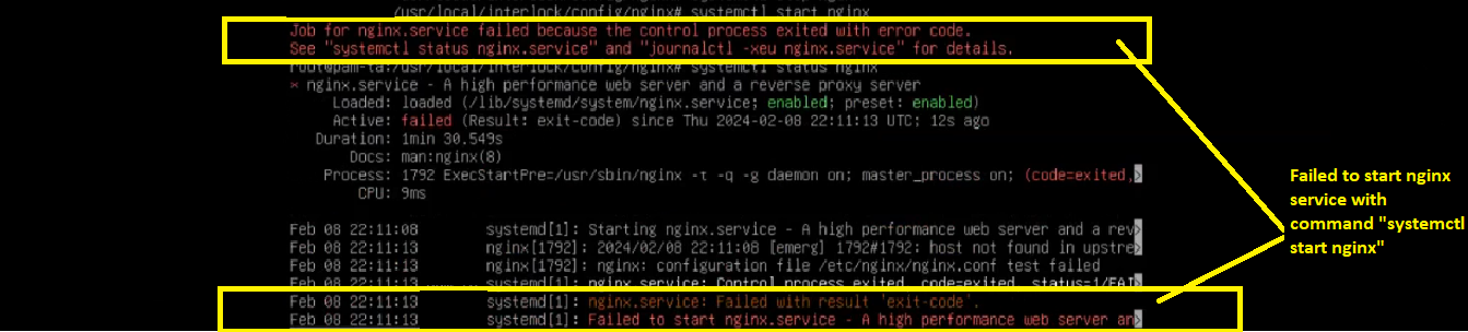

A reboot did not resolve the issue as nginx service fails to start automatically. In addition, usage of "systemctl start nginx" command also does not start the nginx service and fails as shown below:
All supported Threat Analytics versions
The nginx service cannot start up on the TA server with error "host not found in upstream". Essentially, the DNS translation was not possible due to either DNS server in a stopped state or a firewall restricted the access from the TA server to the DNS server.

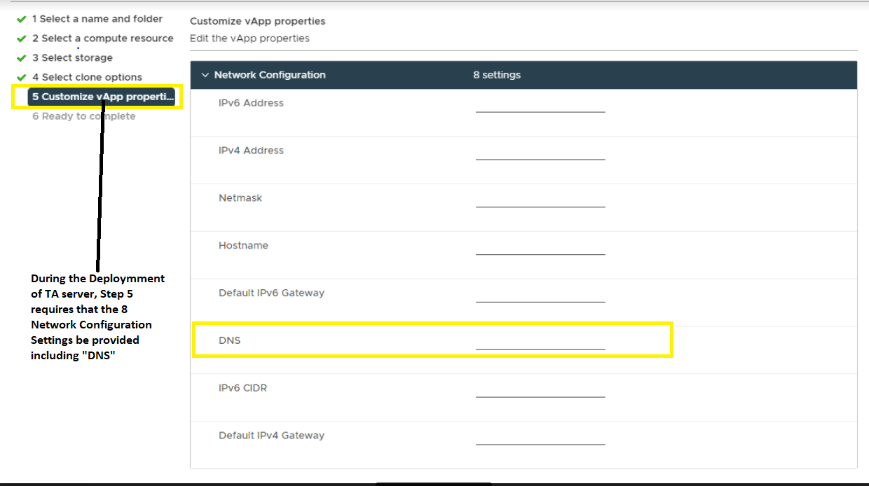

4. Note that During the deployment of the TA server, DNS settings can be provided.
Please ensure the following:
1. The nameserver switches need to be in resolv.conf file located in /etc directory of the TA server.  Add "nameserver IP_ADDRESS_OF_DNS_SERVER" " for as many DNS servers you have configured.
2. Test using nslookup.
3. Once nslookup resolves correctly, now you can go to the /usr/local/interlock/config/nginx and in these three .conf files (namely, admin_app.conf, TAPtoPAM.conf and TAPui.conf) use the $hostname instead of explicit IP addresses.
