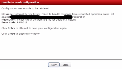

When trying to open the probe configuration in AC, the following error message is received:
Unable to read configuration
Configuration was unable to be retrieved.
Message: Internal Server Error: Failed to handle response from requested operation probe_list against /domain/hub/robot/controller
Resolution: Please check the ppm.log file for additional details
Error Code: PPM-018
