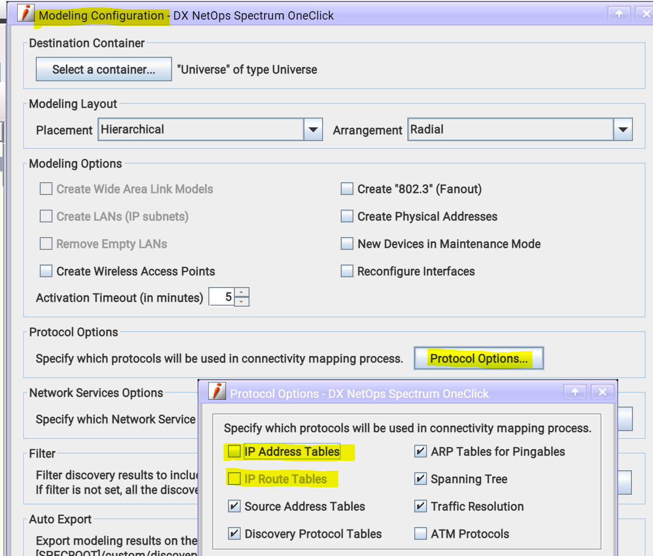

Upong review of the $SPECROOT/SS/ADiscDebug* file created, it was noticed when reading ip route tables of these devices, they both showed each other as a next hop router, so Spectrum will make this connection.
If layer 3 connectivity is not required, configure the AutoDiscovery not to read ip route or address tables in the Modeling Configuration section of the discovery configuration.
Please reference the "Discovering and Modeling Your Network" section of the documentation for more information.
