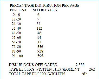

Once a journal block size is selected the output from a number of ARCHIVE JOURNAL jobs should be reviewed to determine the general percentage of space used on a journal file's blocks. Figure 1 shows a sample space utilization histogram produced by the ARCHIVE JOURNAL utility.
Figure 1
If the majority of pages fall into the higher utilization range of the histogram it is probably an indication that the selected block size for the journal file is too small and should be adjusted so that there is mix of page space usages with the average page usage in the 70 to 80% range.

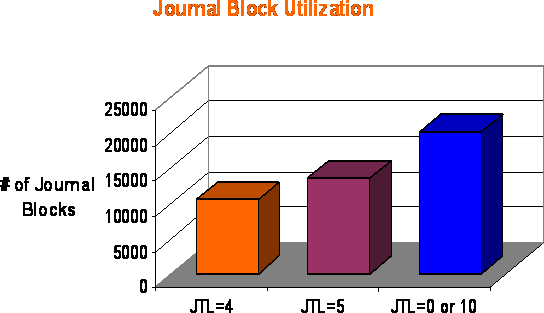

The graph in Figure 2 shows the number of journal blocks that were written to perform 20000 debit/credit transactions at varying journal transaction levels. In this example the most benefit was derived by setting the journal transaction level to 4. More than 50% fewer journal blocks were written to perform the same volume of work compared to what was required when the journal transaction level was set to 0 or 10. A value of 0 disabled the journal transaction level while a value of 10 resulted in an environment where there were rarely enough active update transactions to cause the writing of journal blocks to be deferred.

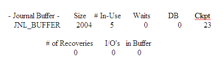

A journal buffer should minimally contain 5 pages and may benefit from many more pages in active systems that incur many abends that lead to database recovery. The adequacy of the journal buffer pool can be monitored by issuing the DCMT DISPLAY BUFFER command.
Figure 4
In almost every CV the most important statistic in Figure 4 is the number of waits. The number of waits should always be zero. When an I/O is started on a journal buffer the buffer is flagged as unavailable and the next buffer becomes the active journal buffer. Upon completion of the I/O the buffer being written again becomes available. Many journal buffers may be unavailable at any one time because they are all concurrently in an I/O state. If all of the buffers in the journal buffer pool are unavailable the next request for a journal buffer will add to the wait count. Therefore if the wait count is non-zero it means that all of the buffers in the pool were in a wait state at the same time and all transactions had to wait for a journal buffer to perform an update operation.
When the wait count is greater than zero the number of pages within the journal buffer should be increased until this number is once again at zero. Increases in the pool size should be made in small increments as a small change can have a visible change in the number of waits encountered.
In a few CVs that experience high numbers of recovery operations there may be some value in defining a large journal buffer pool. The '# of Recoveries' in Figure 4 represents the number of aborted transactions that had to roll out updates and 'I/Os' are the number of journal blocks that were read to perform the recoveries. The 'in Buffer' value is the number of journal blocks that were found within the journal buffers and therefore did not require an I/O operation to be performed.
Recovery will not use the CV's journal buffer pool to read the journal but maintains its own buffer consisting of a single page. Recovery will search the CV's journal buffer pool to locate a required BFOR image and if found copies that buffer's contents into its own buffer causing the 'in Buffer' value to be incremented. If a CV is very active and is writing journal images at a high rate the BFOR images for an aborted transaction may not be in the journal buffers by the time the recovery starts. This is especially true for abends resulting from deadlocks and timeouts. If the CV does a large number of recovery operations increasing the journal buffer pool to a large number such as 300 or 400 may result in an increase in the value of the 'in Buffer' statistic indicating a more efficient recovery environment. However if the 'in Buffer' value remains small after making the increase the enlarged buffer pool is probably just wasting storage space and should be reduced to the minimum level where journal waits will be maintained as zero.
