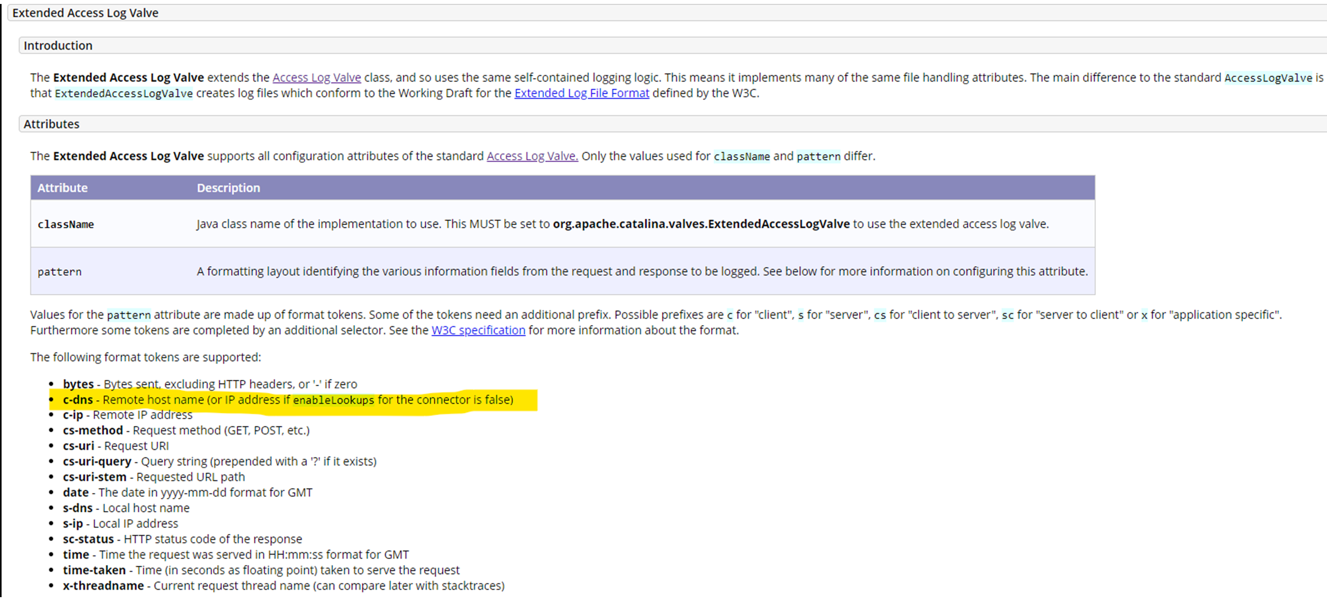

4. I have noticed the following:
https://tomcat.apache.org/tomcat-9.0-doc/config/valve.html#Extended_Access_Log_Valve
Maybe we could use/enable the Extended access log valve in the localhost_access log to get the hostnames too?
Engineering: In order to use ExtendedAccessLogValve, we need to add this class to the server.xml file like below:
<Valve className="org.apache.catalina.valves.AccessLogValve" directory="logs" prefix="localhost_access_log." suffix=".txt" pattern="%h %l %u %t %r %s %b %D" resolveHosts="false"></Valve>  // This is already present in the server.xml file.
The below line should be added newly:
<Valve className="org.apache.catalina.valves.ExtendedAccessLogValve" directory="logs" prefix="localhost_access_log." suffix=".txt" pattern="c-dns c-ip" resolveHosts=" false "></Valve>
