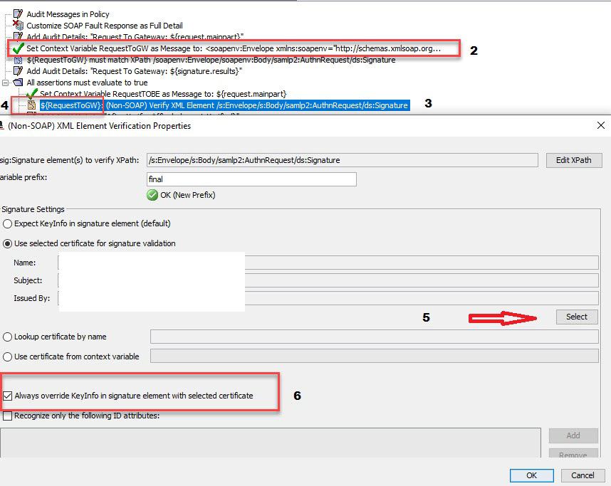

  1. Install the x509 certificate using policy manager - Certificate manager, then add the certificate and check Certificate is a Trust Anchor”
  2. For the Incoming Authn request store the SOAP request in context variable - inthe policy
  3. Add the assertion “(Non-SOAP) Verify XML Element Assertion” to the Policy Development window.
  4. Right click on the assertions, then “Select Message Target'' Check “Other Context Variable” enter the context variable used to save the Authn Request ( i.e. RequestToGW from the screen capture)
  5. Select the certificate in the Signature Settings
  6. MUST check “Always override KeyInfo in signature element with selected certificate”
Always override KeyInfo in signature element with selected certificate - Select this check box to always use the selected certificate, regardless of whether the <ds:keyInfo> element specifies a certificate
Clear this check box to use the selected certificate only if the <ds:keyInfo> element does not specify a certificate. If it does, it will be used instead of the selected certificate. This setting is the default.
