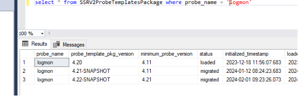

2. Deploy both templates packages in order to the robot running mon_config_service (generally the primary hub)
They will be listed in the database like this:

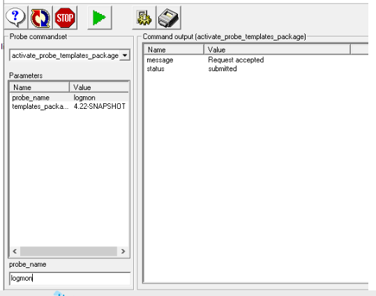

3 .Migrate profile(s): CTRL+P on mon:config_service
execute:
activate_probe_templates_package
probe_name = logmon
template_package_version: 4.22-SNAPSHOT
If you need to update to 4.21-SNAPSHOT, that should be the first package that is migrated, and then you would check to make sure it has migrated, then update to the 4.22-SNAPSHOT using the same process.
Check if it is migrated:
After this new profiles were created with 4.22 Profile even if we leave an empty qos name in the UI, the probe will print <Default> and QOS will be collected immediately:
