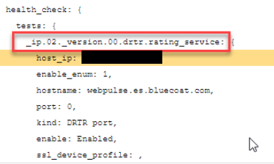

Example:
In order to remove the "_ip.00._version.00.drtr.rating_service" from under the "health_check" section, you'd enter "['_ip.00._version.00.drtr.rating_service']" in the Compare Config job configuration:
